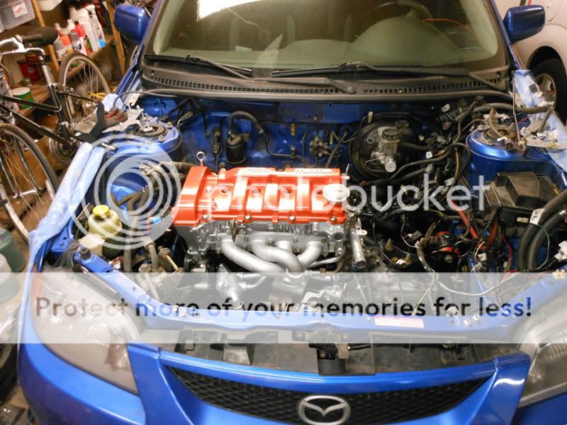

Welp it's been awhile since I've posted in here. Nothing to report but pics of the nice clean motor getting dirtier and dirtier as wires and hoses and shit get hooked up.
Finally got her pieced together enough to give the motor a test crank and get some oil flowing, and it looks like I have a starter problem :signs066:
I heard the solenoid click, immediately followed by a sound like the whine disposable cameras make when the flash is recharging. Probably had the key in the start position for 1/2 second or so. Poked my head under the car to look for any signs of a wiring problem, but I couldn't see anything out of the ordinary. Now all I get is a loud click from the solenoid. Blargh.
Welp, starter problem was just a ground strap that wasn't quite tightened down. Got oil pressure almost right away when I started cranking it, so I went ahead and hooked up the plugs and injectors. Fired right up with no drama!
