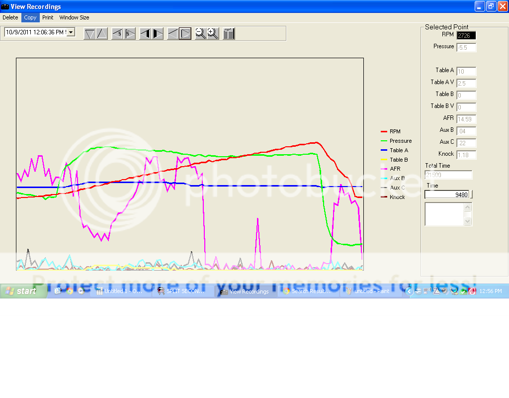

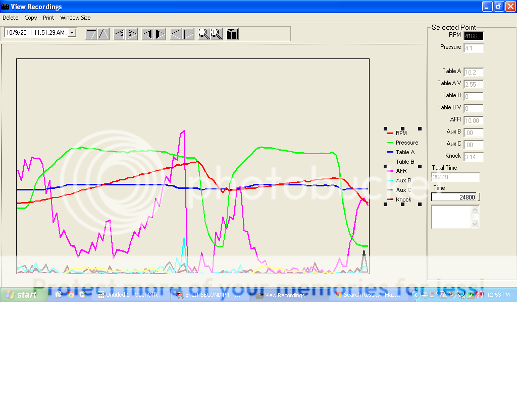

Headed out and logged a couple of pulls today. Too much traffic for anything but a couple squirts down on-ramps, but it should give you all an idea what I'm working with. It's pretty representative of what I'm seeing. Note that I'm dumping in extra fuel from 3000-4500 rpms where most MSPs are removing fuel.
Red=rpm Green=boost Purple=AFR
3rd, 4th gear. 3rd gear, I got on it about 2800rpm and let off at about 4200, right after AFRs shot up. The AFRs started climbing at 3500.
3rd gear, 2900 - 4900 rpms. That lean spot is 3600-4000 rpms.

Ho-kay. I think I have things sorted out in theory. I was under the impression that the car went into open loop under a combination of high load and rpm range. But after some more reading, it appears open loop is triggered at approximately 4k rpms, regardless of load or boost (fuck you very much, mazda).
So, the ECU is trying to hold N/A type AFRs up until 4k rpms, which you can see nice and clearly by the richening that happens during spool-up, followed by leaning out as the ECU plays catch-up. I think my solution is going to be something like this http://www.flyinmiata.com/index.php?deptid=4536&parentid=0&stocknumber=07-46300
There's also this guy, also from SplitSecond http://splitsec.com/products/Enricher.htm which looks like it has a lot of functionality, but would probably be overkill since I only need to richen things out over a very small area.

Anyways, I just had another HERP DERP moment when I realized the SplitSecond actually has a built-in O2 clamp. It's just set up very strangely in the software, and I'm not 100% sure how to adjust it. But, with the clamp enabled at 0psi, I now run 10-10.2 AFRs all the way from 3000 up. Time to start pulling fuel and adding powah*!

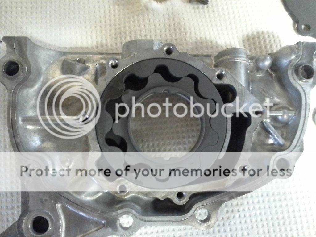

Teardown didn't reveal anything too horrible. Definite metal fragments in the oil pan and embedded in the main bearings, but no scoring of the crank journals. Crank was polished, block was thoroughly cleaned out, and on assembly, all clearances are checking out nicely. To beef up the oil system, I had Doc B racing (probably one of the few professional organizations with any experience making the FS-DE into a semi-reliable performance motor) modify an oil pump to use an external pressure regulator and ceramic coat the pump internals to tighten up all the clearances.
New pump with SwainTech coated internals

Dinged up the front oil seal when seating it in the oil pump today, so as far as I got was pre-packing the oil pump with grease, tapping an oil return hole in the main bearing girdle, and cleaning everything up for installation.
