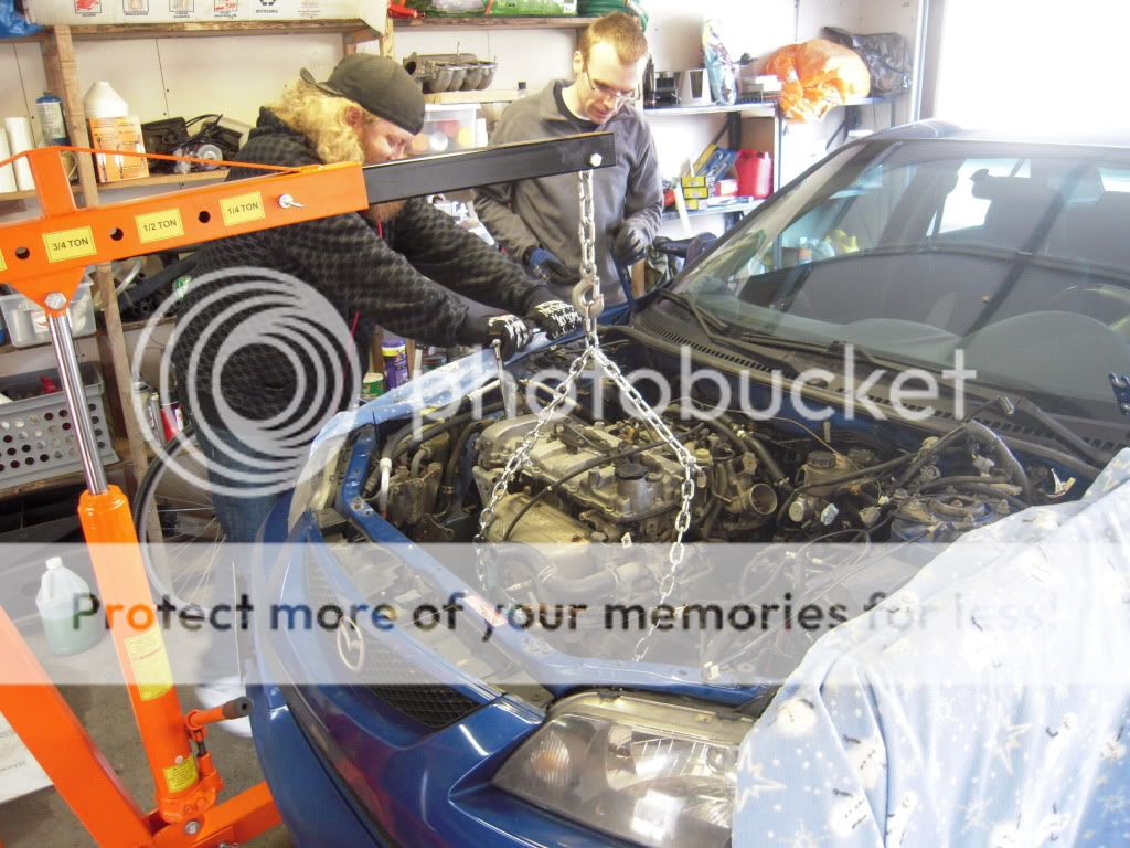

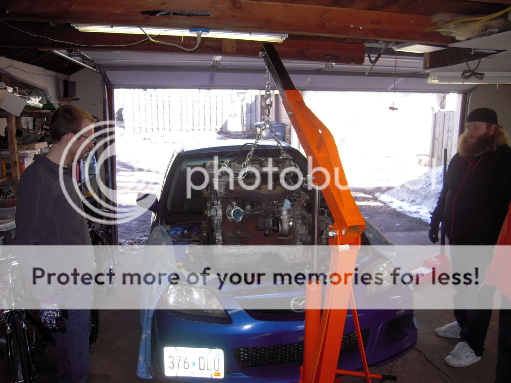

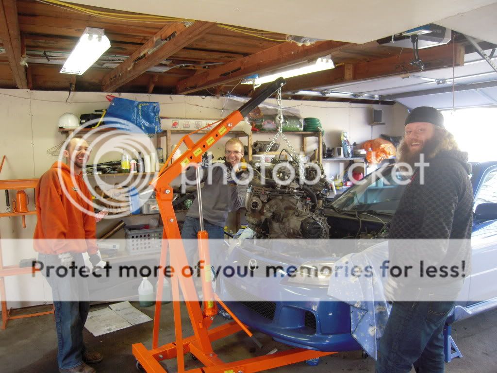

As you can see from Picklz' post, the engine came out today--thanks to the help of Tom, Colin and Matt. We hit a few small snags, but nothing that couldn't be solved with a BFH and some cursing, haha. Picklz posted the lulzy pics already, but here's a couple more from engine removal day:
It's hard to see in the pics, but I only had about 2-3" between the end of the hoist's boom and the ceiling in the garage.
Tom showing off my new rally-style ride height up front

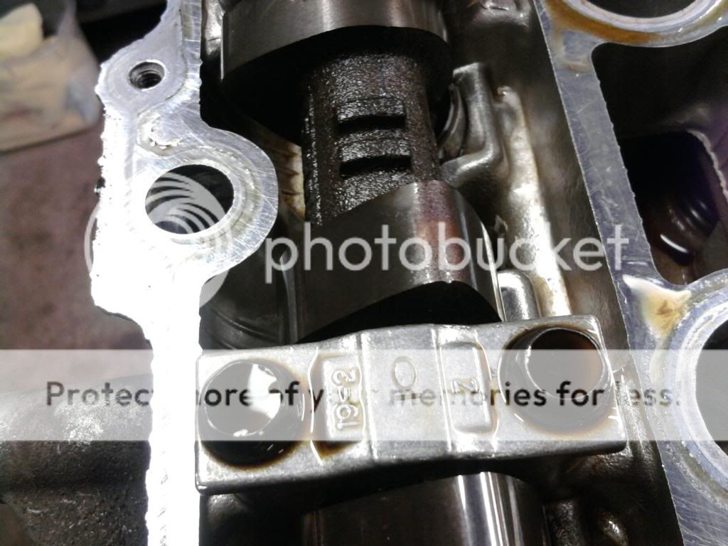

Popped the valve cover today, and noticed that one of the lobes on the exhaust cam had a rough, rusted appearance at the peak. The rest of the cams have some slight signs of wear on the lobes, but only the one is actually rusty like that. Any thoughts on this? It hasn't been all that long since I've driven the car... probably about a month.
As long as the lobe itself ends up in spec, I wouldn't worry much. Probably a *little* bit of starvation up there, which means the motor didn't have a ton of time left, but as long as you clean it up fine and the surface that actually touches the valve for actuation isn't off kilter, you'd be fine. Prolly just got a little condensation in it when you pulled the coil packs or something.
