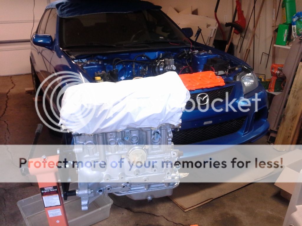

    Engine is fully assembled... just need to get another coat of enamel on there, bolt on the accessories, and then drop it back in. Quick cellphone shot with valve cover by Powder Keg in the background.

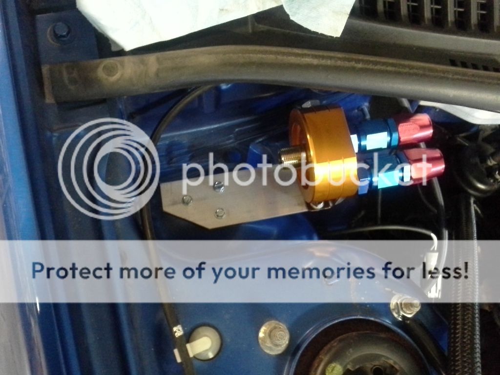

    Mocked up the oil system yesterday. Had to ghetto fab a couple of brackets out of some 1/8"x2" aluminum bar stock I had laying around, but I'm fairly happy with the results.
    Oil filter mount and bracket behind the passenger side strut tower. Should be plenty of room to get a 3.5" long filter on and off

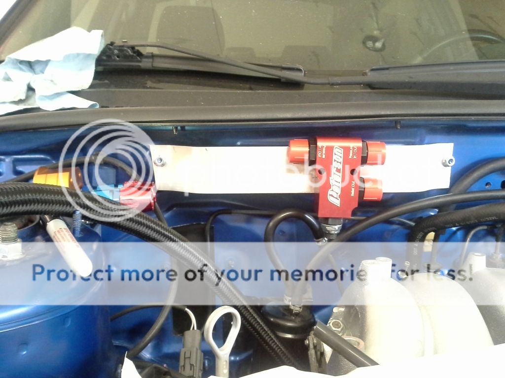

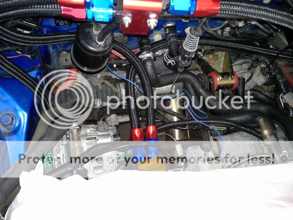

    Bracket I made to mount the pressure regulator and a few other items that used to be mounted directly to the IM. Note that I had to move the charcoal canister down to get it out of the way... NBd, just moved the mounting bracket down by one stud, "reshaped" the bracket to let the canister lie closer to the firewall, and bent the metal line into position.

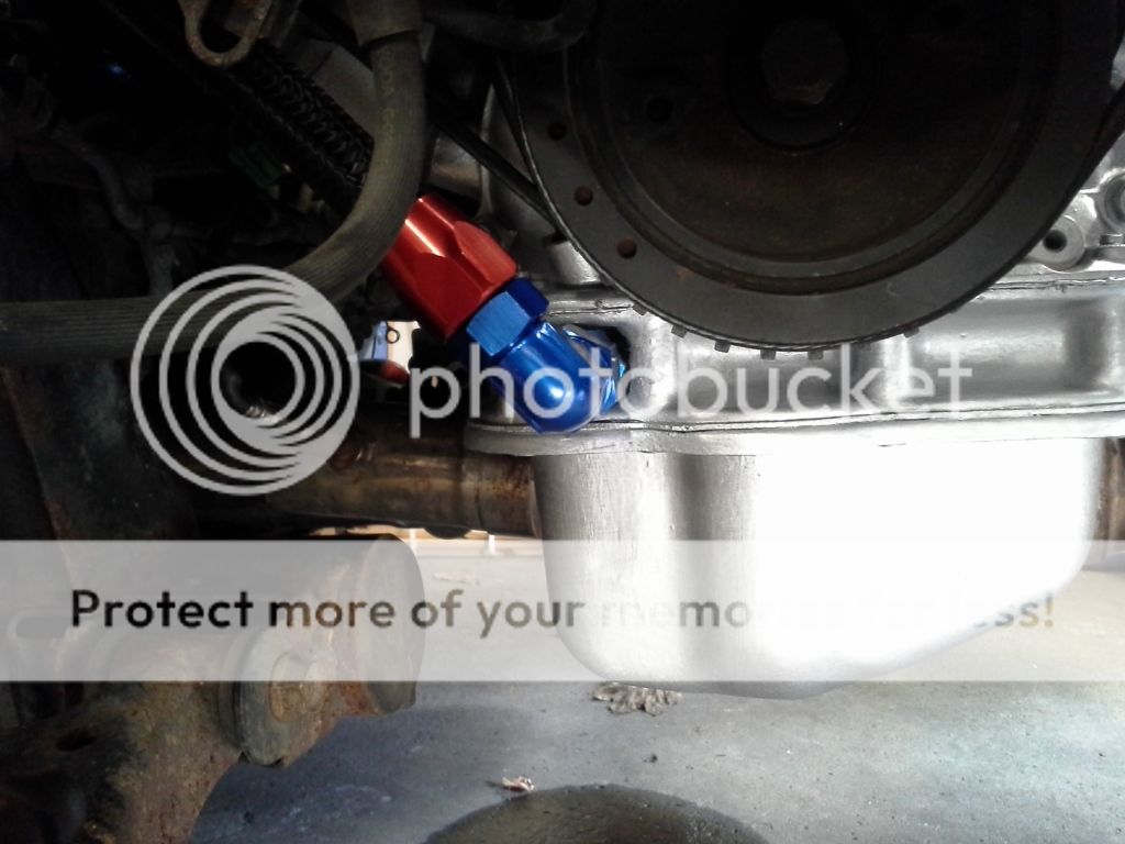

    Quick shot of where I tapped the MBSP for the oil relief return. (also, dat rusty subframe o_o)
    Mocked up location for pressure regulator.
    I need to get another 90 degree fitting to complete everything, but I think I've got the routing and placement all figured out.

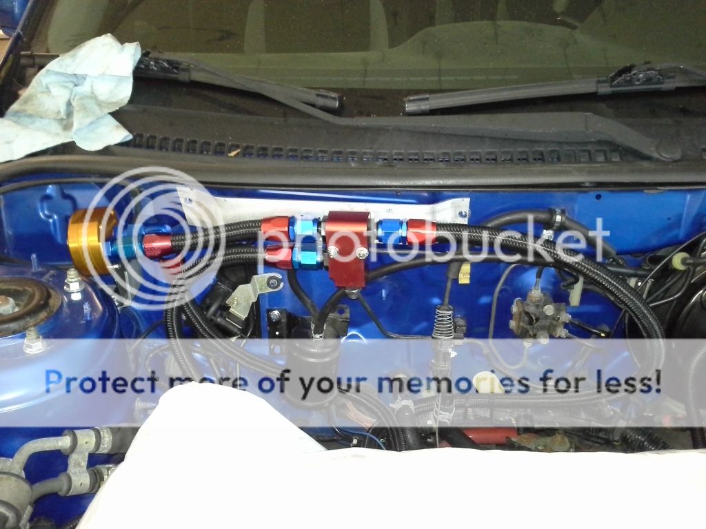

    Okay, pulled the intake mani back out and test fit all the lines.... pics:
    Cory, if it helps you later on, I used my master level MS Paint skills to add some fancy annotations:
    [​IMG][​IMG]

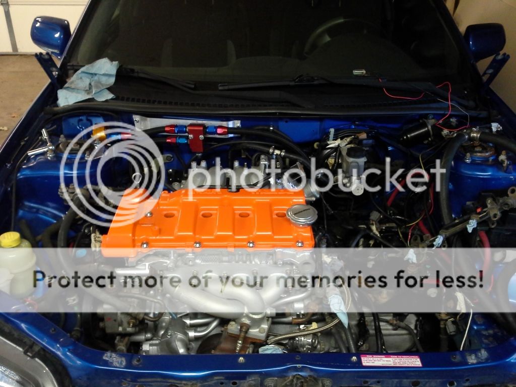

    Quick shot of progress as of today. Spent about 2 hours wrestling with a fuckin axle. Hate those stupid circlips.
    I couldn't get the orange to show up properly. It is most excellent in person.
    Oh, and there are twenty-seven 10mm sockets hidden in that pic. Bonus points to anyone who can find all of them.

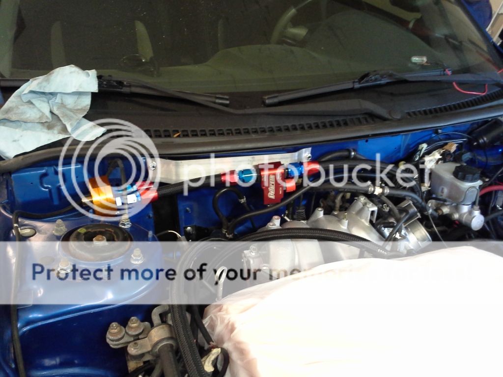

  14. Pretty baller right there.
  15. mndsm
    That, sir- is excellent. Kudos to you.
  16. Big Nate
    Big Nate Chaos Engineer
    Looks great. Very nice clean engine bay.
    One thing, how are you not going to dump oil all over the shock tower every time you change the oil?
  17. dmention7
    dmention7 Hater
    Thanks guys :)
    Also, Nate, I haven't figured that part out yet. The oil filter mount tilts down towards the filter a bit, so the oil *should* run off the edge of the mount, as opposed to dribbling down the bracket. I was thinking about trying to find a small plastic container that I can slide under the filter when doing oil changes, but it's still probably going to make a mess.
