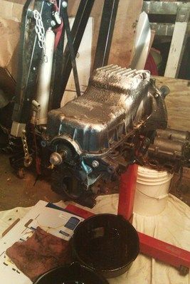

    Rolled her over to remove the oil pan.
    Due to a "mounting" problem with the stand, I had to improvise.
    After an hour of wrestling the oil pan off due to rtv sealer and the stupid slosh tray or whatever, it's off.

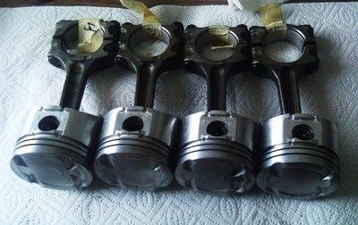

    And my internals all laid out and ready for some lovin'
    And lovin' is what I gave them

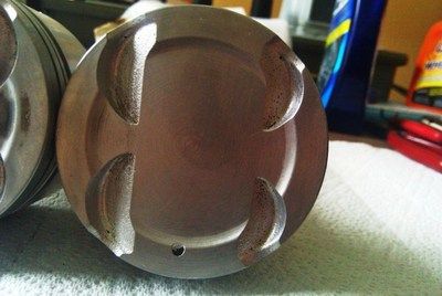

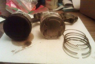

    Pistons got a deep cleaning to get the gunky carbon build up off of them.

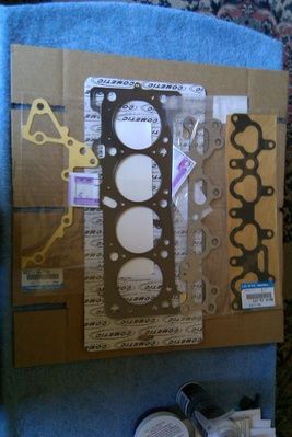

    And lastly, my rebuild kit came in courtesy of Flyin' Miata.
    Some gaskets
    Timing belt kit
    And all the other goodies

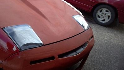

    Lights finally came in

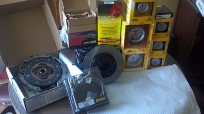

    All of my parts came in from renown-performance which included new control arm bushings, brake rotors pads and stainless lines, my new set of gauges, and new clutch and pressure plate.

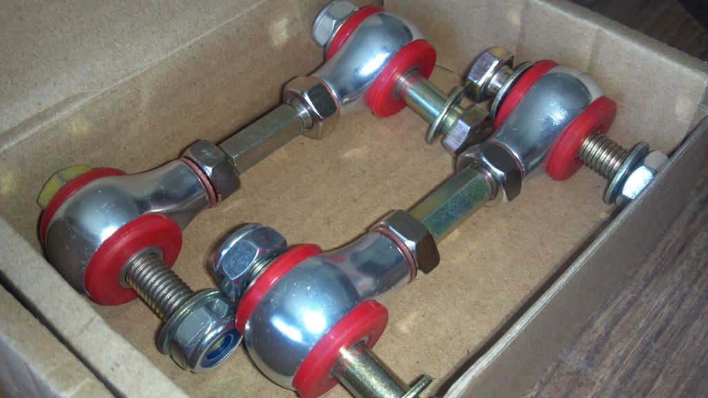

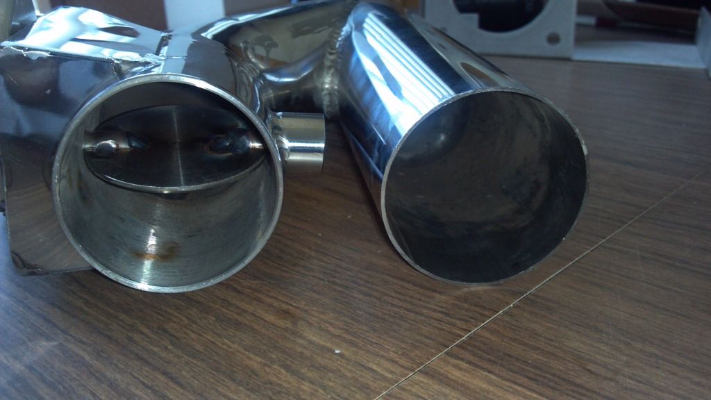

    Also got some new endlinks and electric exhaust cutout from riceland.

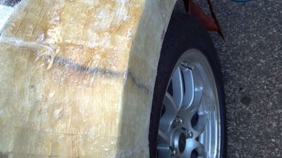

    Also have been working on the body work. Front fenders and rear spoiler are being shaped.

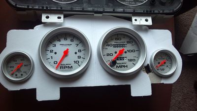

    Started mocking up my new gauge cluster housing.

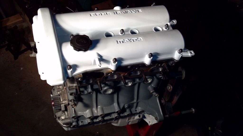

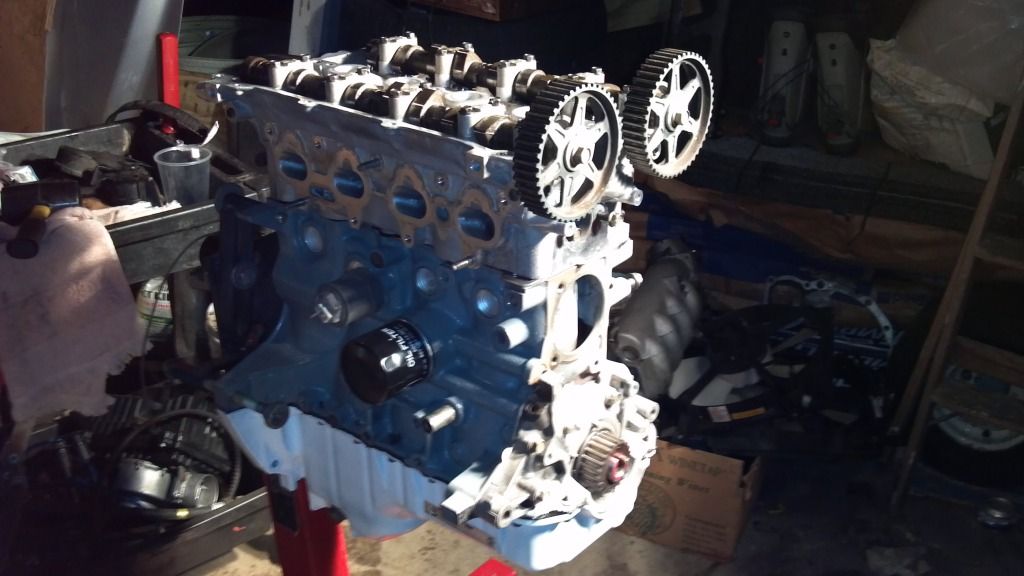

    Engine is back from renown and under reassembly

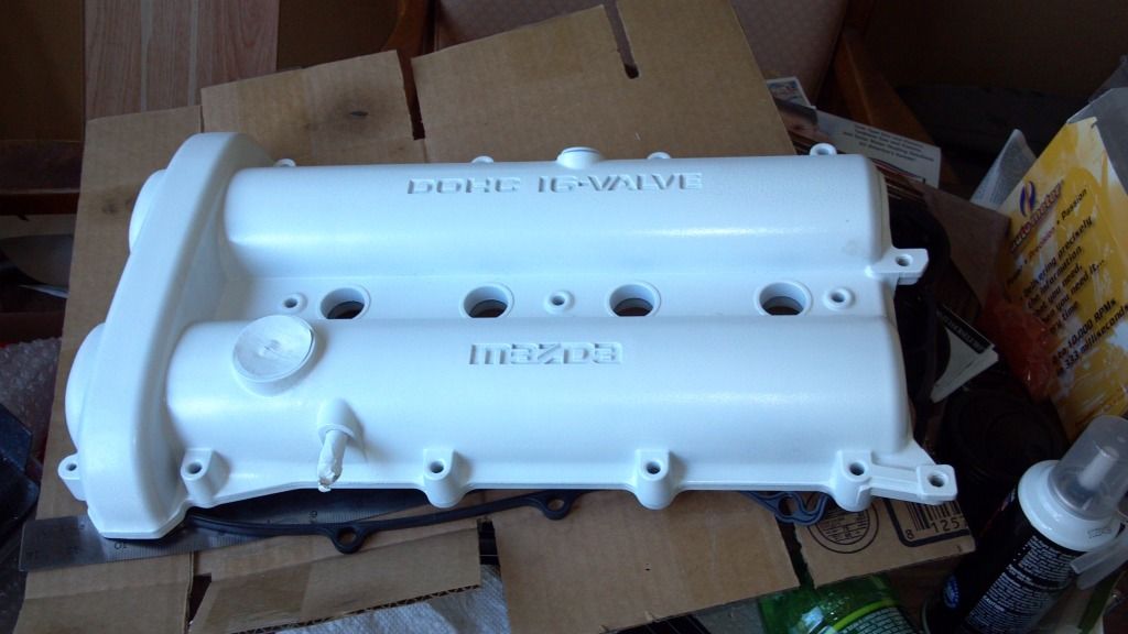

    Got the oil pan and valve cover cleaned and painted too.

    Block is already painted grey and ill leave the head just raw and cleaned. Tranny, vc, oil pan, and some other stuff will be white. Engine bay and most other stuff will be painted black.

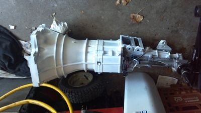

    Got the tranny all painted up and ready to go.

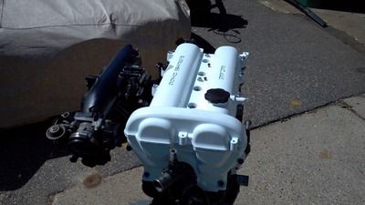

    And got the intake mani painted up and mounted.

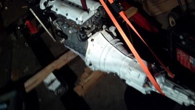

    Clutch and stuff finally on.
    Trans is finally on.
    Sunday is the day. Will she run, or asplode?!

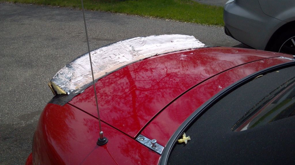

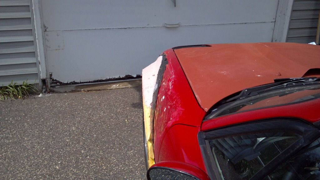

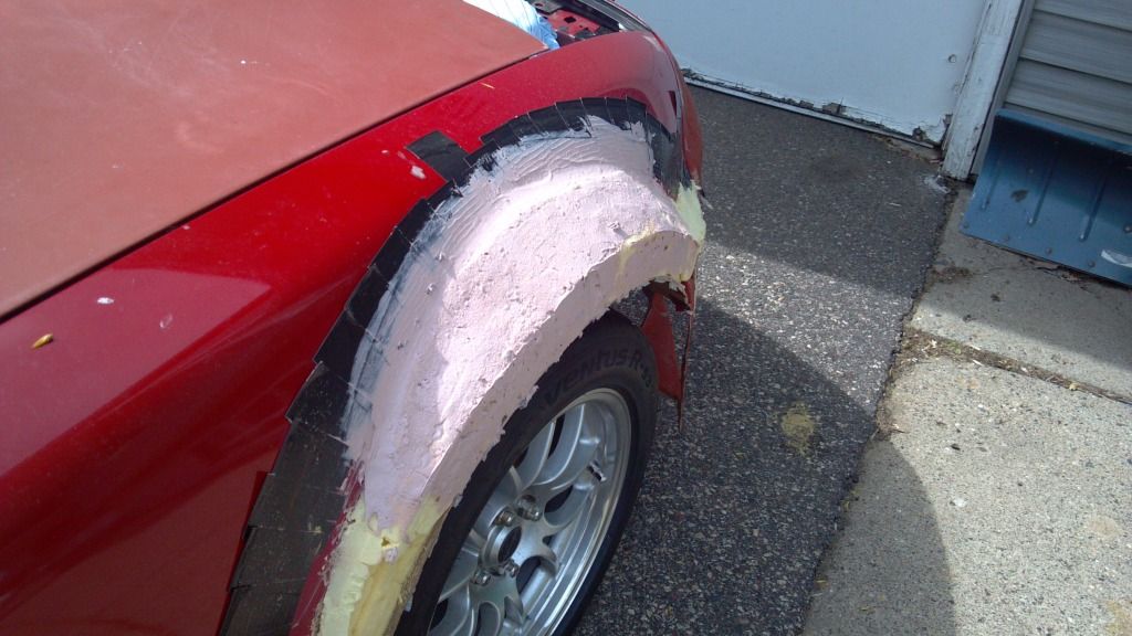

    In other news. Fiberglassing of the front fenders has begun at last. Also, the side skirts are in the shaping process.
    Teaser shot:
