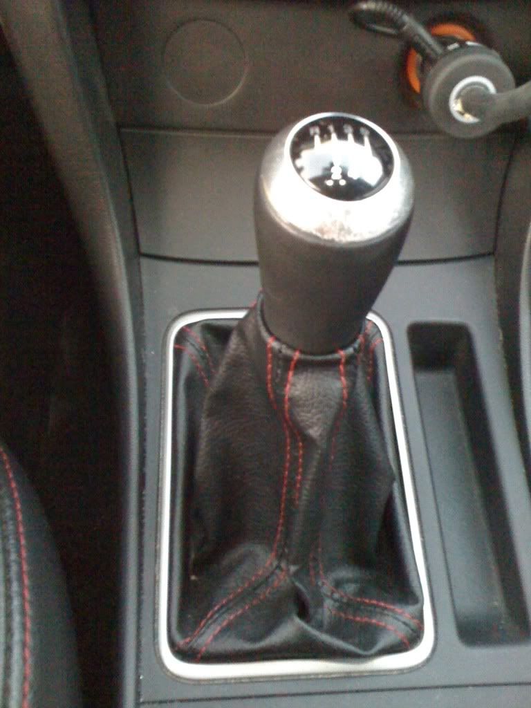

PICS! (I tried to keep the angle the same for all the pics, but it was tough)
Stock shifter in 1st, 2nd, 5th, 6th
E4P Shifter in 1st, 2nd, 5th, 6th

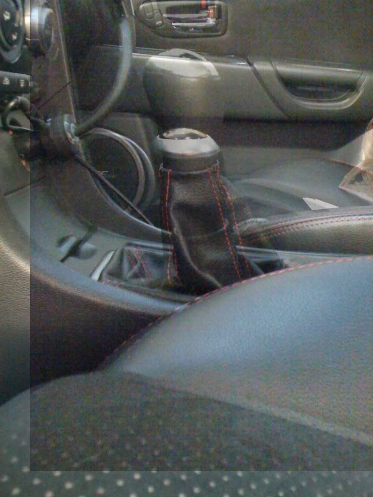

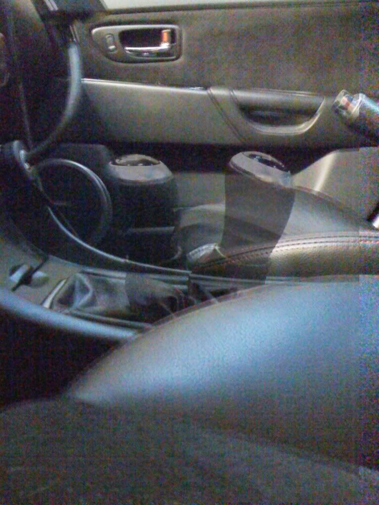

Pics of the throw, before and after overlayed on each other, courtesy of derrian and her mad photoshop skillz.
1st gear:
2nd gear:
MOAR Pics with fancy photoshoppin by Joelle:
Stock shift from 1-2:
E4P Shift from 1-2:
