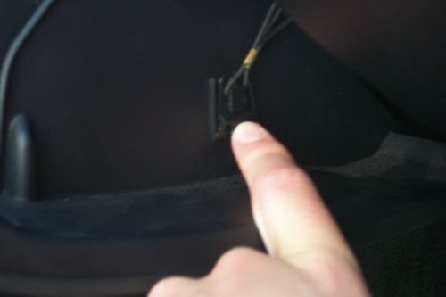

    2. Locate the snap lock on the right outside wall of the glove box. It has a elastic strap or string attached to it.
    [​IMG]
    3. Pull the tab on the bottom edge of the snap lock out and push down to release it from the hole in the side of the glove box.

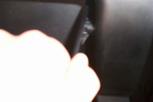

    4. On each side of the outside walls of the glove box are small knobs. These knobs are the stops that hold the glove box from opening further. Using both hands, push in gently on the side walls of the glove box until the knobs can clear the surrounding walls.
    [​IMG]
    Then, pull out to open the glove box fully and lower it all the way down. The hinges of the glove box may slide out as well. No worries you can easily slide the hinges back into place.

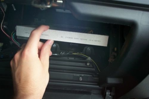

    7. Remove the filter by pulling it out and gently to the left to avoid the metal bar that’s in the way.
    [​IMG]
